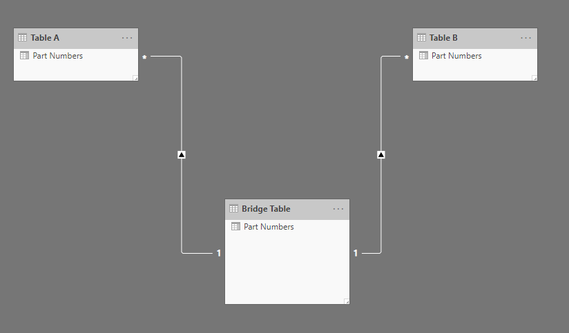

1. Create a calculated table.
Bridge Table =
DISTINCT (
    UNION ( VALUES ( 'Table A'[Part Numbers] ), VALUES ( 'Table B'[Part Numbers] ) )
2. Create relationships.
Icey

Hi @Anonymous ,
Please check if this is what you want:
Bridge Table =
DISTINCT (
Icey

Hi @ImkeF - Since both Table A and B contain duplicates... the bridge table would display all part numbers and the one 0 with no duplicates.
That way Table A can have a relationship with Bridge table and,
Table B can have a relationship with the Bridge Table.
