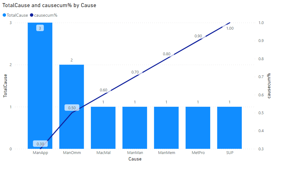

Then I create a line and stacked column chart with SampleSum[Cause] as the x-axis, Measures0[TotalCause] as the column y-axis, and Measures0[cumcause%] as the line y-axis. In the desktop app, this works as expected. However, when I publish it to my workspace, the cumcause% measure works differently.
Shown in the desktop, filtered to RP = 07/01/2023, 09/01/2023, and 10/01/2023:
And exactly the same graph in my workspace, with the same filters:
What is causing this inconsistency, and is there a way to create the same functionality that will work equally well in both the desktop app and in the service?

Hi @AKirk ,
You can refer to below screenshoots. In my tests, set the minimum value of the secondary y-axis to 0.3, (or customize the range you need). Then after publishing it to powerbi service everything works fine.
after publish to service, everything well done.
Adamk Kong
That didn't change anything for me.
Desktop:
After publishing to the service:
