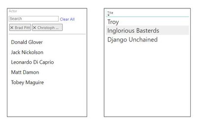

Hello everyone,
I am trying to use the "Attribute Slicer" to select and filter the output of another table.
Currently when a value from column 1 is selected in the slicer, the linked value to is given as output:
However, my goal is to display only the commune value, in this case "Inglorious Basterds" would be the right output.
But i cannot find a way to change the condition of this selection from OR to AND. How can i do this?
I am sure you guys can help.
Please find the pbix file in the following link:
Sample.pbix
Thanks in advance.
  • Hi AndreaPiscitell ,
    We can create a measure use following formula, then put it into the Visual Filter of Table as following picture:
    FilterMeasure =
    IF (
        COUNTX (
            DISTINCT ( 'Sample'[Actor] ),
            IF ( [Actor] IN FILTERS ( 'Sample'[Actor] ), 1, BLANK () )
        ) + 0
            = COUNTROWS ( FILTERS ( 'Sample'[Actor] ) ),
        1,
        0
    Or the simple version, it should have the same result
    FilterMeasure_SimpleVersion =
    IF (
        DISTINCTCOUNT ( 'Sample'[Actor] ) = COUNTROWS ( FILTERS ( 'Sample'[Actor] ) ),
        1,
        0
    BTW, pbix as attached.
    Best regards,
    Community Support Team _ Dong Li
