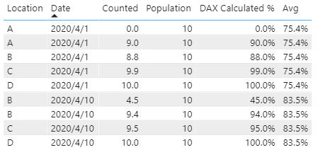

If you want to calculate the average by DAX Calculated % measure, you may try my way.
I use measure to achieve your goal.
Avg =
var _a = SUMX(ALLEXCEPT('Table','Table'[Date]),[DAX Calculated %])
var _b = CALCULATE(COUNT('Table'[Location]),FILTER(ALL('Table'),'Table'[Date]=MAX('Table'[Date])))
return
DIVIDE(_a,_b)
Result:
You can download the pbix file from this link: Aggregation Problem in a Line Graph
