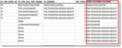

I need to add a new column with conditions but also to pull a value from another row if a certain condition is met.  Below is my table and columns, here are my conditions:
  • If FEE_TYPE = 2 and SF_FIN_SERV_ID <> null then SF_NAME1
  • If FEE_TYPE = 2 and SF_FIN_SERV_ID is null then "NATIONWIDE"
  • If FEE)_TYPE = 1 then SF_NAME1 where SF_FIN_SERV_ID = "TP"
The first two are fairly easy for me, it's the last one that's giving me trouble.  Basically, whenever the FEE_TYPE = 1, that value also needs to be THE PENSION DESIGN GROUP.  I just can't seem to figure out the right syntax for this.  I also added an example of what this should look like.

Thank you, this is helpful.  That said, I should have been more clear about the data.  The example I gave here is just a subset.  The SF_NAME1 column has thousands of rows.  There should have been another column named 'PLAN' in my example.  So this subset of data would be for Plan 10.  I've added a new example of what I'm expecting.  So based on your first solution I'm getting the max value in SF_NAME1 for every row that meets that condition when I really need it only for Plan 10, and then a different value for Plan 20, etc.  Sorry for the initial confusion and hopefully this helps.
