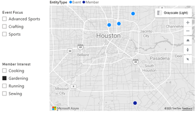

Wow DataNinja777 - thank you so much!
I really appreciate you taking the time to write out this elegant solution so clearly.
I have successfully recreated your recommendation using my example data.
Base Map:
Map with Member filter applied:
Map with Event and Member filters applied:
In my real life scenario both my Members and Events data sets have many attributes that will all need to be filterable. I believe I have worked out a way to extend this model with additional attributes - here is my code which includes additions for an Event Date filter that appears to work as required.
Show Location =
VAR SelectedEntityType = SELECTEDVALUE(MapData[EntityType])
VAR SelectedAttribute = SELECTEDVALUE(MapData[Attribute])
VAR SelectedEventDate = SELECTEDVALUE(MapData[Date])
VAR IsEventSelectionMade = ISFILTERED('Event Focus Slicer'[Attribute])
VAR IsMemberSelectionMade = ISFILTERED('Member Interest Slicer'[Attribute])
VAR ISEventDateSelectionMade = ISFILTERED('Event Date Slicer'[Date])
VAR IsEventVisible =
    IF(
        AND(NOT(ISEventSelectionMade), NOT(ISEventDateSelectionMade)),
        TRUE(),
        AND(SelectedAttribute IN VALUES('Event Focus Slicer'[Attribute]), SelectedEventDate IN VALUES('Event Date Slicer'[Date]))
VAR IsMemberVisible =
    IF(
        NOT(IsMemberSelectionMade),
        TRUE(),
        SelectedAttribute IN VALUES('Member Interest Slicer'[Attribute])
    IF(
        (SelectedEntityType = "Event" && IsEventVisible) ||
        (SelectedEntityType = "MEmber" && IsMemberVisible),
        1,
        0
Output:
