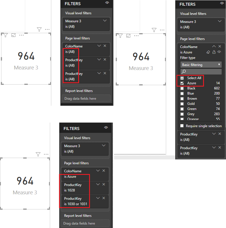

A Measure That Ignores Page Level Filters
