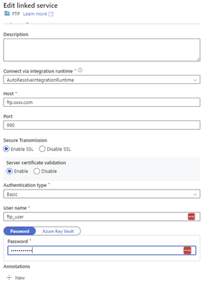

I have tested this within Azure Data Factory and setup a linked service to the same vendor FTP server and this works fine as the connector in Azure Data Factory has additional options for SSL etc, please see below for reference -
So how can I overcome this issue in Fabric? or will my integration solution need to leverage Azure Data Factory to move the files from FTP to a Blob Storage Account and then setup the Pipeline in Fabric to ingest from the Blob Storage Account?

Hi @nicworth ,
In that case, you can load data to ADLS Gen 2 or Blob Storage using ADF and later you can use Fabric Pipelines to pull the data from ADLS Gen2 to Lakehouse.

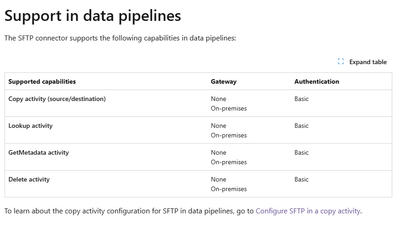

If you are looking for SFTP connectivity, can you please check this - SFTP connector overview - Microsoft Fabric | Microsoft Learn
Hope this is helpful. Please do let me know incase of further queries.
It is not SFTP, it is an explicit TLS FTP protocol that is only supported by the vendor system. Protocol "ftpes://", as said this is achieveable in ADF but it appears the connector in Fabric Data Factory does not have the same features unfortunately.

Apologies for the late response, yes you have answered my query. We will use ADF connecting to ADLS gen2 to ingest the data for the time being. I will also see if I can submit the feature/enhancement request as you have advised.
