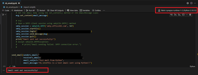

I tried the codes from this blog (How to send emails using Python and Office365 SMTP server | by Vipul Bajaj | Medium) in a Fabric notebook and got the same "SMTPHeloError: (501, b'5.5.4 Invalid domain name....." error in Fabric portal.
However, when I ran the same Fabric notebook in the VS Code with Synapse VS Code extension, and used Fabric runtime 1.2, I sent the email successfully! You may give this a try.
