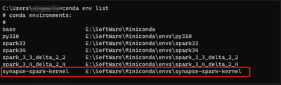

You should use the synapse-spark-kernel for your notebook code to run without any error.
I have attached the screenshot for your reference.
While adding the Synapse VS code extension into your Visual Studio, there are some prerequisites which have to be installed in your local desktop. If you install those prerequisites successfully, then extension will auto create the synapse-spark-kernel and install pyspark and other packages. You will able to find this environment after installing all the prerequisites.
Maybe you have installed conda, but forgot to set the environment variable.
When you activate the extension, it will show the initialization progress and output in output channel like this:
Please refer this document for installing the prerequisites : Link1
Hope this helps. Please let us know if you have any further queries.

@Anonymous thank you for your swift reply.
I missed the prerequisites, thats likely why it doesn't work indeed. I think the link you meant is this one: link2.
It works now thanks!
