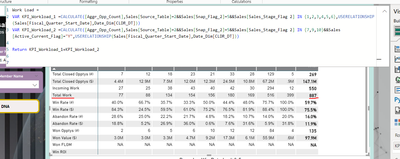

hello,
this is my matrix and for the Total Work the total is not correct.
these are the dax codes used:
Aggr_Opp_Count = DISTINCTCOUNT(Sales[HPE_Opportunity_Id])
Work Load =
VAR KPI_Workload_1 =CALCULATE([Aggr_Opp_Count],Sales[Source_Table]=2&&Sales[Snap_Flag_2]=5&&Sales[Sales_Stage_Flag 2] IN {1,2,3,4,5,6},USERELATIONSHIP(Sales[Fiscal_Quarter_Start_Date],Date_Dim[CLDR_DT]))
VAR KPI_Workload_2 =CALCULATE([Aggr_Opp_Count],Sales[Source_Table]=2&&Sales[Snap_Flag_2]=5&&Sales[Sales_Stage_Flag 2] IN {7,9,10}&&Sales[Active_Current_Flag]="Y",USERELATIONSHIP(Sales[Fiscal_Quarter_Start_Date],Date_Dim[CLDR_DT]))
Return KPI_Workload_1+KPI_Workload_2
Could anyone help me in this matter?
Hi @Ally87 ,
Have you solved your problem? It's hard to tell exactly what the problem is based on your screenshots and DAX alone.
If you haven't solved your problem, please provide the pbix file at your convenience. If it's not convenient, please provide a bit of sample data and the data table structure, as well as the table-to-table relationships, that would be helpful.

Hi @Ally87 ,
I think so because of the formulation -> Aggr_Opp_Count = DISTINCTCOUNT(Sales[HPE_Opportunity_Id])
It retrieves unique values for each dates. But for the total, again formula retrieve unique values all table. That means, there is an intersection  on your data concerning your condition. You used "userrelationship", could you please control dates on third table (Sales[Fiscal_Quarter_Start_Date]) to detect whether intersection among condition 1 and condition 2 ? looking for a kind of duplication.
