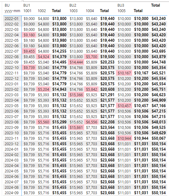

The resultant intermediary visualization is as shown below.
Then I've written the measure below for the final output analysis.
Salary by month value =
VAR result =
    MAXX (
        'Salary table',
        IF (
            'Salary table'[Start Date] <= MAX ( 'Calendar'[Date] )
                && 'Salary table'[End Date] >= MAX ( 'Calendar'[Date] )
                || 'Salary table'[Start Date] <= MIN ( 'Calendar'[Date] )
                    && 'Salary table'[End Date] >= MIN ( 'Calendar'[Date] ),
            'Salary table'[Monthly Salary]
    SUMX (
        VALUES ( 'Calendar'[yyyy-mm] ),
        IF ( [Changed date] = BLANK (), result, [Prorated for changed month] )

In order to make the month with the salary change stand out, I've highlighted those month in pink using the following color dax formula.
Change month Color =
VAR result =
    MAXX (
        'Salary table',
        IF (
    IF ( [Changed date] <> BLANK (), "Pink" )
Then used that color measure in the conditional formatting of the output measure which sumxes over employee and BU.  This produces visualization like below, which highlights salary change month for easier visual identification.

Selected previous year = VAR Previous=max('Calendar'[yyyy])-1
 return
 calculate([Salary by month value sumxing over employee & BU],'Calendar'[yyyy]=Previous)
Finally, for year over year salary change which respects your year slicer selection:
Year over year change = divide([Selected year salary],[Selected previous year])
The resultant final output is as shown below.
Last but not the least, the the data model used for this excecise looks like below:
As mentioned before, the calendar table is kept as a disconnected table to enable flexible duration analysis while separate employee and BU dimension tables were created using summarize table function, as there are multiple employees in the salary fact table, we needed to link the fact table with the employee dimension table in order to
sumx over the dimension table to get the correct summation over the employee ID.
