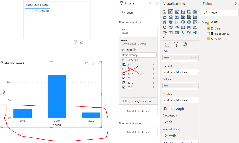

how to Show the last 3 years in report
I am tring to get the last 3 years in my report. it look like i have in my report years 2020 , 2019, 2018, 2017,2016,2015
i wnat to show onaly 2020,2019,2018
also if the year change to 2021
it should update to
2021,2020,2019 and hide 2018, 2017,2016,2015

@Anonymous , if the year is coming from date. Use relative date slice
https://docs.microsoft.com/en-us/power-bi/visuals/desktop-slicer-filter-date-range
nandic
Hi @Anonymous ,
You need to filter data in Power Query.
As @AllisonKennedy  mentioned, you can use built in functions to calculate last N months, years, days.
But if you want to make sure it calculates years, where last 3 years are 2018, 2019, 2020 no matter which current month it is, here is approach:
1) create new column for year based on data in table: Date.Year([Date])
2) create new column for current year: Date.Year(DateTime.Date(DateTime.LocalNow()))
3) create new column to calculate difference between current year and year in data: [Current Year]-[Year]
4) filter this colum to show only number 0,1,2 (it will filter only last 3 years)
Cheers,
Nemanja

I have similar problem but i'm not able to decide how to put your solution into it.
I just want that when i click at the slicer of year (same as the one in the question) I should see the graphs as it is but along with that in the other visual i want to see only the past 3 years of sales/profit in number.
Can anyone please guide me. I did for the current year and  last year by using the SAMEASLASTYEAR formula, visualised on the card. However, i tried alot of things but failed to do for last 2 years or mainly N-1, N-2 and N-3 year
Thank you so much in advance !
