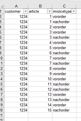

i need help on a measure to calculate a quote. I have a table like this:
To get the quote i need the distinctcount article where the invoicetype is "nachorder". This is no problem
 CALCULATE(DISTINCTCOUNT(Article, invoicetype = "nachorder"). The problem is i need also the distinctcount where the invoicetype is "nachorder" and not "vororder"
CALCULATE(DISTINCTCOUNT(Article, invoicetype = "nachorder" && NOT(invoicetype = "vororder"))
but this doesn't work, can somebody help me with this measure?
Thank you in advance

Hi @morizf
I suggest to create a calculated column to exclude values first:
IsValid Column =
IF (
        COUNTROWS(MyTable),
        ALLEXCEPT ( MyTable, MyTable[Article])
        <> CALCULATE(COUNTROWS(MyTable), ALLEXCEPT(MyTable, MyTable[Article], MyTable[invoicetype])),
    FALSE(),
    IF (
            VALUES ( MyTable[invoicetype] ),
            ALLEXCEPT ( MyTable, MyTable[Article], MyTable[invoicetype] )
            <> "nachorder",
        FALSE(),
        TRUE ()
And later on, count over this column:
Measure = CALCULATE(DISTINCTCOUNT(MyTable[Article]),MyTable[IsValid Column]=TRUE())
