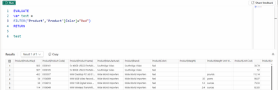

I am new to DAX and am currently reading the Definitve guide to Dax.
Why is it that in the FILTER function, if I use the entire table in the first paramater, I can run the query with or without wrapping the first parameter in ALL function like this
However, is the first parameter is a column, I have to use the ALL function, otherwise I get an error
why is that?

The first thing to note with the FILTER function is that the first argument must be a table.
These are both valid table expressions:
  • ALL ( 'Product' )
  • 'Product'
When no filters have been applied, ALL ( 'Product' ) is equivalent to 'Product', except that ALL ( 'Product' ) will contain an additional blank row (corresponding to values in tables on the many-side of a relationship with 'Product' that do not exist in 'Product').
For your first two DAX queries, when no filters have been applied, the queries both return the same result (since this particular filter condition automatically excludes the blank row if it exists):
EVALUATE
VAR test =
    FILTER ( ALL ( 'Product' ), 'Product'[Color] = "Red" )
    test
EVALUATE
VAR test =
    FILTER ( 'Product', 'Product'[Color] = "Red" )
    test
For your second set of queries, 'Product'[Color] is a column reference, not a table expression, so it is not valid as the first argument of FILTER.
You can convert a column reference to a table containing the values of that column using functions such as ALL, VALUES or DISTINCT.
  • ALL ( 'Product'[Color] ) returns a single-column table containing all values that exist in the column 'Product'[Color] ignoring any filters that may exist, including the possible blank value.
  • VALUES ( 'Product'[Color] ) returns a single-column table containing all values that exist in the column 'Product'[Color] within the filter context where the expression is evaluated, including the possible blank value.
  • DISTINCT ( 'Product'[Color] ) is similar to VALUES ( 'Product'[Color] ) except the possible blank value is not included.
Two queries that return single-column results in a similar fashion to the first two queries would be:
EVALUATE
VAR test =
    FILTER ( ALL ( 'Product'[Color] ), 'Product'[Color] = "Red" )
    test
EVALUATE
VAR test =
    FILTER ( VALUES ( 'Product'[Color] ), 'Product'[Color] = "Red" )
    test
-- OR --
EVALUATE
VAR test =
    FILTER ( DISTINCT ( 'Product'[Color] ), 'Product'[Color] = "Red" )
    test
