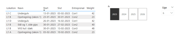

I got 48 locations. Im useing a year and week slicer to find what activies are going on, across all locations, in the given timeperiod. This gives me the following:
Each activity has a contracter related to it (Con1, Con2 and Con3 in the above), a unique ID (Even though they have the same name) and a weight. I need a measure that will find the activity with the lowest weight based on location and return the contracter related and return blank on activities with a higher weight in the same location. On the following picture im trying to descripe that. The yellow column is the measure I need.
