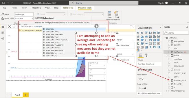

Hope someone can help me on this. I am attempting to use a measure to calculate another measure. I know this works based on tutorials. However, I am geting the error "The AVERAGE function only accepts a column reference as the argument number 1." I am using PowerBI desktop version: Version: 2.105.961.0 64-bit (May 2022).
Does anyone know if the ability to use a measure to build another measure was introduced in a newer version of Power BI desktop?

Thank you. Here is the project. I have measures created already but when I attempt to create a new measure, I am not seeing those measures available (see below)
When I do attempt to use a measure "Summary_Total", I am getting an error that the function will only allow a column referernce. I know from tutorials that I should be allowed to reference an existing measure to build a new measure. I am wondering if this is an issue with the version of PowerBI desktop that I am using.

Rico,
Thank you. That worked. Truly appreciate it.
