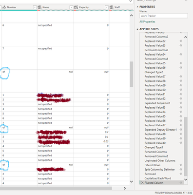

Hi @Anonymous @lbendlin @Greg_Deckler
So, I have done the transformation after alot of head scratching (working off Gregs M code in this post was actually not complete as per the original post- never mind).
I do have a couple of issues before moving on to the visuals and DAX side of this:
I have 2 issues in the table
1. There is a mystery 'of' under the iteration through the staff numbers in the column 'Number", which also throws a 'null' in it's corresponding 'Name' column
- I assume of have created this through some mistake in the Query- Query as follows (ignore the first chunk as previous queries- take from "Unpivoted Other Columns":

Secondly, I have a good number of rows that are repeats of the Work Item to handle the different staff on the work item, but are redundant because there are no names against the work item.
For example, under the current query applied, all work items are split out by 7 to handle the 7 (potential) different staff allocated to that work.
In practice, we prob have a good number of work items that dont have the full 7 staff allocated. How do I remove rows where there are no staff allocated against?  I assume it is some type of Remove Column where a condition is met?

ie
1. The mystery 'of' and corresponding null value
2. Removing rows (and on an ongoing basis) where there are not resources for a given work item
Many thanks

Hi @lbendlin
the code above works in so far as it creates the new table with resource and capacity by work ref as you stated- thank you.
I have some follow up queries:
1. The pbix file I provided was the table structure I have, but was a based on a copy of the SharePoint list source with had dummy names in to ensure it was anonymised data. When I run your code on my actual data, I get the names Jim, Gus etc which are not the actual names.
How do I get the code to work on my actual source data?
2. How do remove the resource name and capacity columns from the Work Tracker table. and unpivot it?
3. WIll the previous code you provided in 'worked.pbix' work given the data is now split into two tables? If not, what code do I need to do the calcualtion, inclduing removing any non-working days based on the dimDates table?
Many thanks
