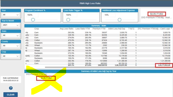

Desired Outcome #1:
The top right card visual needs to correctly display the Total "Adtnl Loss Adj Exp" across multiple selected years.
- This can either be a static number of years (e.g. 10 years hard-coded into the measure)
- OR it should be the selected years in the "Year" slicer
For example, if I keep slider slicer values constant (150%, 100% & 10% respectively) and only change "Year to Model",
the correct total $ for each YTM (Year to Model) is as follows:
2021 = $30,835,812
2022 = $78,723,649
2023 = $71,350,756
2024 = $69,025,807
The new card visual needs to TOTAL all of these $ values over all the selected Years (or hard-coded years) in the "Year" slicer.
For example, if the Year slicer theoretically had only these 4 years selected, then the card visual needs to show the SUM of these 4 years.
$30M + $78M + $71M + $69M = $249.9M
NOTE: What's confusing here is that the "Year to Model" slicer is being used to correctly calculate multiple columns in the "Summary - Main table", which then impacts which rows are included/excluded, and thereby impacts the total $ amount calculation. However, this new card visual needs to SUM up these same YTM $ amounts for every year in the "Year" slicer (or a hard-coded # of years in the measure). If ALL years are selected in the "Year" slicer, then the card should show the total $ amount for all years.
Desired Outcome #2:
The same calculation in the new card visual above needs to be broken out in a table visual by Year.
Once again, in the example below, I'm pretending that only 4 years are selected (2021-2024).
However, we need to do this:
- Either across all years selected in the "Year" slicer
- OR by a hard-coded number of years in the measure (e.g. last 10 years)
Very thankful for any help on this one,
Nathan

Thanks again for taking the time to respond.
Unfortunately, your solution is not what is needed.
Your solution shows only a single value in the lower table visual. (Screenshot 1 below).
Also, it does not show the Year column.
Also, it only displays the value for the Year to Model.
This is not correct.
I need the lower table visual to show 2 columns: Year & $ Amount. (Screenshot 2 below)
And it needs to display rows for ALL years; not the Year to Model only.
Thanks again for your time.
Nathan

Just had a breakthrough - I'm 50% of the way there.
1) The Card Visual total across all 4 years is now correctly returning $249M.
2) The Table Visual summary that breaks down the $249M across all 4 years is not yet working.
- Still haven't figured this part out.
Here is the solution that's currently working for the Card Visual correctly returning $249M.
Thrilled that the Card Visual is working.
Still stuck on the Table Visual.
Any help on that part would still be greatly appreciated.
Nathan

Not sure, but perhaps this might be helpful in understanding where I am stuck.
Below is my attempt at the new measure.
As you can see, the Card Visual works in the first half of the measure, but not the second.
- It correctly returns $30.8M for YTM 2021. (VAR 1)
- But incorrectly returns $123M (instead of $249M) for all 4 YTM years (2021-2024). (VAR 2)
NOTE 1: In this version of the measure, I am returning VAR vPremiumAdj_CurrentYTM.
This is just done as a checkpoint test to make sure it's working before going farther - and it is working.
NOTE 2: As mentioned previously, SummaryMain is not a table in the model; so I have to recreate it as a CALCULATETABLE VAR called vSummaryMain.
Now comes the problem where I am stuck.
For test purposes, I am hard-coding the same 4 years in the measure that we previously discussed. (2021-2024)
Now my goal is to iterate over these 4 years, treating each year as the YTM to correctly calculate and return the SUM total of $249.9M.
Unfortunately, my code is incorrectly summing only the $ amount for the currently selected year in the "Year to Model" slicer (in this case 2021 = $30.8M) and multiplying it by 4, and wrongly returning ~ $123M (instead of the correct $249M).
CORRECT: $30M + $78M + $71M + $69M = $249.9M
INCORRECT: $30.8M + $30.8M + $30.8M +$30.8M = $123M
Below the measure is updated to RETURN vPremiumAdj_MultYears.
SOLUTION CHALLENGE: VAR vPremiumAdj_CurrentYTM needs to be able to IGNORE the YTM slicer value, and calculate each year as a separate YTM. But I am not sure how to do this. How do I get VAR vSummaryMain & VAR vPremium_Adj_CurrentYTM to calculate with an ITERATING/CHANGING YTM from VAR vYTMYearsTable?
Again, not sure if this is helpful, but this is where I am stuck.
Nathan
