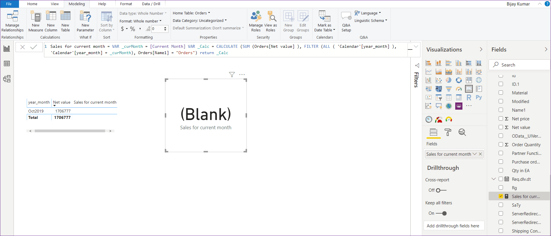

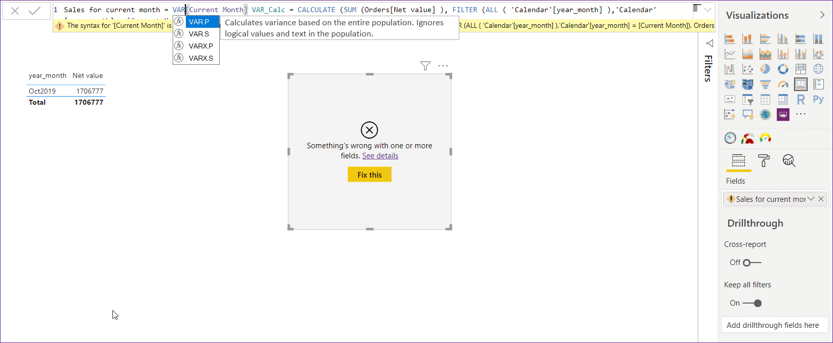

Hi @Nathaniel_C ,
I have added a Card from the Visualization. When I am adding this rule in the measure, it is not taking the variable name as only VAR and it is showing the error.
I think it is expecting the variable name should be either VAR.P, VAR.S, VARX.P or VARX.S as you can see in the below screenshot.
Also, After adding the rule as you sent, this below error is appearing. Here, the Current Month represents another measure that I have used to get the current month.
Please, can you suggest me if anything else I have to do?
Hi @PreetiSahu321 ,
Sorry, have to give a name with Var. Try var _curMonth = [Current Month]
Nathaniel
Hi @Nathaniel_C ,
I have added the Variable name. Now no error is coming, but still the total Net value is not appearing in the Card as you can see in the below screenshot.
Please, can you suggest me anything else if you have any idea?
