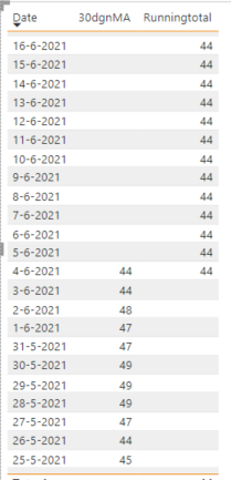

Hi, im not sure if this is possible so hope someone can give some answer on it.
I have a measure and it results in this:
However i need the running total / cummulate the amounts... in this case :
days after today 44,88,132,176, etc etc ...
I thought by using this part i should be able to cummulate all the previous numbers :
"DIM_Dates[Date] >= maxdate,
ALL(DIM_Dates)))"
Would appreciate some help if its possible to calculate running totals based on measures, like i posted above instead of "sum" etc..

Your variable MA is fixed once calculated, so putting it inside the CALCULATE doens't get you new numbers.  Try deleting that variable and replace MA with whatever your desired calculation is (e.g., SUM of a column?) in your Return.
Pat
I tried that but also doesnt get me the result.
Maybe better to decribe the total calculations/measures:
1) I have a measure that counts the nrs of rows in a (filtered) table. (measure 1)
measure1=
CALCULATE( COUNT('abc'[def]),
FILTER('abc',
NOT( 'abc'[ghi]= "1" && 'abc'[jkl] = "2" ) ))
2) from that measure i calculate the 30days MA (measure 2)
measure2=
VAR Datum = MAX(DIM_Dates[Date])
If(Datum > TODAY(), BLANK(), CALCULATE(
AVERAGEX(
DATESINPERIOD(DIM_Dates[Date],
MAX(DIM_Dates[Date]),
-30, DAY), CALCULATE([measure1],DIM_Dates[Werkdag]=1)),DIM_Dates[Date]=TODAY()) )
2) from that measure i want to have the running totals starting today, just like here https://www.sqlbi.com/articles/computing-running-totals-in-dax/  (Runningtotal)
Runningtotal=
VAR maxdate = MAX(DIM_Dates[Date])
return
CALCULATE(
[measure2],
DIM_Dates[Date] <= maxdate,
ALL(DIM_Dates )))
still getting the same number instead of it cumulating....
