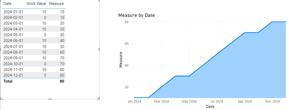

    Hi yazenbarakat123 ,
    I create a table as you mentioned.
    Then I create a measure as you mentioned.
    Measure =
    VAR _currentdate =
        MAX ( 'Table'[Date] )
            SUM ( 'Table'[Stock Value] ),
            FILTER ( ALLSELECTED ( 'Table' ), 'Table'[Date] <= _currentdate )
    Yilong Zhou

      Hmm  I seem to be running into the same issue where the line cuts off the blank month
      The Incidents Table does not have any incidents for the month of may so I connect it to a calendar table
