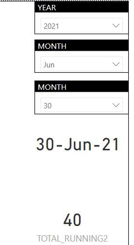

I am trying to do sum of number of employees based on Date Filter also need to consider employees Termination Date while doing sum.
I have written below dax to do cumulative total but its not showing correct output.
ISTERMINATED2 = IF (ISBLANK (Sheet1[terminated_Date])=TRUE(),1,
IF ((Sheet1[terminated_Date]) <= SELECTEDVALUE('date'[Date]),0,1)
TOTAL_ACTIVE2 = CALCULATE(COUNTA(Sheet1[PRN]) , Sheet1[ISTERMINATED2]=1)
TOTAL_RUNNING2 =
CALCULATE(
[TOTAL_ACTIVE2],
FILTER(
ALLSELECTED('date'[Date]),
ISONORAFTER('date'[Date], MAX('date'[Date]), DESC)
Sample Data : To download Excel I am using to do test.
For Example Till 30-May-2021 I have 40 employees this is showing correct.
In June 2021 month I have 3 termination but output still showing 40 It suppose to show 37.
Please help to fix this issue.
Thanks & Best Regards
Jamsher

I modified DAX and gettting expected results.  Please it will be great help if you can explain the little bit about below dax and also CROSSFILTER what is purpose of it.
Current Employees = CALCULATE(
COUNTX(
FILTER
(Sheet1, Sheet1[hire_date]<=max('Date'[Date]) && (ISBLANK(Sheet1[terminated_Date]) || Sheet1[terminated_Date]>max('Date'[Date])))
,(Sheet1[PRN ])
,CROSSFILTER(Sheet1[hire_date],'Date'[Date],None)
