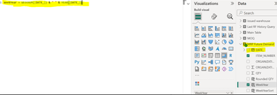

I already sorted the demand for each week of the next year with this column, MRP Future Demand[WeekYear] and MRP Future Demand[Rounded QTY]. When I put WeekYear column int he columns and Rounded QTY in the values sections on a table, it shows me the demand for each week for the next 1 year starting with the current week. the WeekYear column only shows me the week of the year and I created that to sort the data properly in a table visual by using this measure by using the DATE_ column in the table as shown below; FYI just incase it may create a confussion
