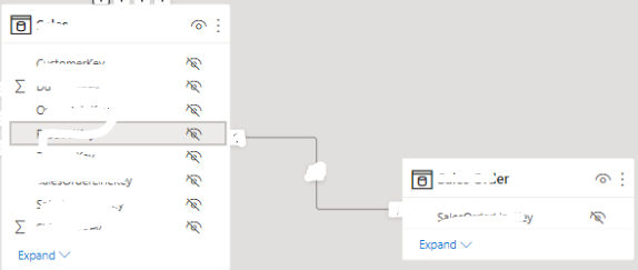

Hi @BasilRudham ,
You can create a dimension table as below using Enter Data method, then create relationship between this dimension table and the table which the index column exist in base on index field.
Create a dimension table
Create relationship
Lastly, put the field [Income Statement] to replace the original index column on the matrix visual. And you can follow the official documentation to apply conditional formatting in your matrix visual.
