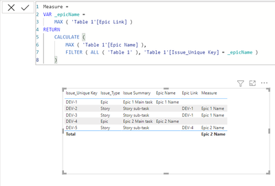

  • smpa01's avatar
    smpa01
    IvanS  you can use this measure
    Measure =
    VAR _epicName =
        MAX ( 'Table 1'[Epic Link] )
            MAX ( 'Table 1'[Epic Name] ),
            FILTER ( ALL ( 'Table 1' ), 'Table 1'[Issue_Unique Key] = _epicName )
    • IvanS's avatar
      IvanS
      Helper V
      Hi smpa01
      for some reason, the function is not working in measure. Please find below - the names in official file are a bit different. You can see that calculated column is getting the Epic name however measure is blank (except one line from the list).
