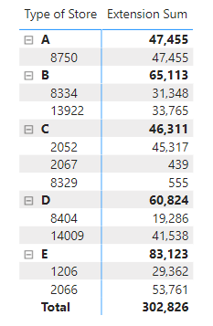

This solution works well. However when I use this measure in a matrix with aggrupated stores, for the type of store also provides a wrong calculation:
Expected result for C stores subtotal should be the sum of the three stores total extention = 1225.
Can you help with this?
Thanks so much!
