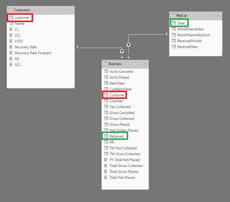

Can you share a sample of your source data so we can work from there, also the data model.
I am uncertain what you are asking for when you want to see a sample of the source data.  There is sensitive information in the data, so I need to be careful about what I am sharing.  Could you please be a little more specific?  Sorry, still a noob.
Here is the data model:
