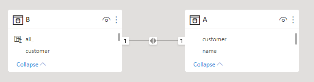

I have create a simple sample. Please refer to my pbix to see if it helps you.
Create a relationship between the two tables.
Then create a measure.
Measure = [Commission]*MAX(A[percent])
If I have misunderstood your meaning, please provide your pbix without privacy information  and desired output.

@amitchandak See below the partial model diagram that is required for this calculation. I'm not sure if I can get you the data. Total Sales Measure is based on the data in the Table highlighted Yellow. Commission percent is available in the table highlighted green. It is not possible to bring the percent into the sales table as more than one salesperson will be compensated for the a sale.
Partial ModelPartial Model
