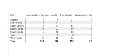

I think that will work.  The first tab has my data and the second tab is what I am trying to create in Power BI.  Below is what I have so far, except the Total Hard Bid column is the one that I'm currently working on and it's 100% correct yet.   I have a lot of learning left to do and multiple classes on udemy already purchased 🙂

The one that you are seeing the the graph that I'm trying to produce in Power BI to look like the below.  The attached is the actual data set.

Honestly, I'm speechless. You have no idea how much I appreciate this and didn't expect you to pull all of that together, but Thank you!
He calculated the prdiction column by multiplying the percentage by pending.
