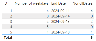

Hi @Jay2022 ,
I create two tables as you mentioned.
Then I create two measures and here are the DAX codes.
NonullDate1 =
IF (
    MAX ( 'Table1'[End Date] ) = BLANK (),
    0,
    MAX ( 'Table1'[Number of weekdays] )
NonullDate2 =
IF (
    MAX ( 'Table2'[End Date] ) = BLANK (),
    0,
    MAX ( 'Table2'[Number of weekdays] )
Next you can create a new measure.
Measure = SUMX('Table1','Table1'[NonullDate1]) + SUMX('Table2','Table2'[NonullDate2])

Thank you I think the problem is i'm actually counting the records based on an id but some of the weekdays that are being counted are 0 due to an end date column (of the spreadsheet) not yet being input. It's a tricky one.
Hi @Jay2022 ,
NonullDate1 =
IF (
    0,
NonullDate2 =
IF (
    0,
