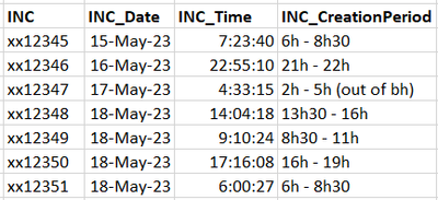

it worked like:

An example of what I expect (using made up data):
