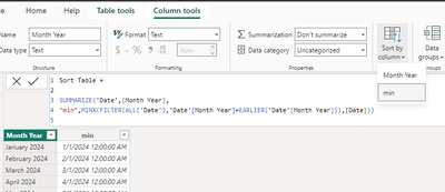

Hi  @ElenaCarciLopez ,
1. Create date table.
Date =
var _start=MIN('Table'[Starting date services])
var _end=DATE(YEAR(_start),12,31)
var _date=
CALENDAR(
    _start,_end)
ADDCOLUMNS(
    _date,"Month Year",FORMAT([Date],"mmmm")&" "&YEAR([Date]))
2. Create measure.
Measure =
var _year=YEAR(MAX('Table'[Starting date services]))
var _number=MIN('Table'[Number of months of our services])
return
IF(
    YEAR(MAX('Date'[Date]))=_year&&MONTH(MAX('Date'[Date]))<=3,
    MAX('Table'[Weighted amount per month.]),0)
3. The default sort method of Power bi is alphabetical, so we need to create a table..
Sort Table =
SUMMARIZE('Date',[Month Year],
"min",MINX(FILTER(ALL('Date'),'Date'[Month Year]=EARLIER('Date'[Month Year])),[Date]))
Select [Month Year] – Column tools – Sort by – [min]
4. Connect the relationship between two tables.
5. Result:
