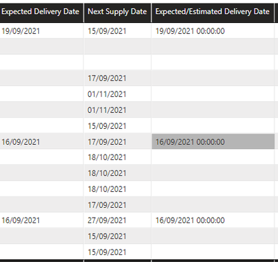

Hi Marc,
Thank you for your solution:  You can view the results below, I'm definitely closer but I should be expecting to see 'Next supply date' in the 'Expected/Estimated Delivery Date' column where 'Expected Delivery Date' is blank but I'm seeing the opposite to that?

Hi Marc,
Apologies I had renamed the column, i've reveiwed this and have posted the results below, the approach you have suggested has indeed returned a value but not what I was expecting.........The theory should be If 'Expected Delivery Date' is blank then show 'Emb Estimated Delivery Date' else show me the 'Expected Delivery Date'
The suggested approach is showing the same value as originally ?
In answer to one of your earlier questions Does any Prod/Colour have a single 'Emb Estimated Delivery Date' or 'Expected Delivery Date' associated? Whilst 'Expected Delivery Date' is blank, there are instances where both 'Expected Delivery Date' & 'Emb Estimated Delivery Date' have a value.

Hi Marc,
I applied the formula but found it didnt like the Emb Estimated Date:
It doesnt give me the option to select from a different table?
So I have used SELECTEDVALUE to access the column from another table and have the below:
However the DAX does not return a value:
I really appriciate your help, my DAX techniques and understanding needs developing as I'm pretty new to Power BI.

Hi Marc,
I very much appriciate your help,
I have created new Column:
I have entered the DAX:
There are lots of blanks in 'Emb Estimated Delivery Date NEW Column' when I would like to be seeing those blanks filled in with the date from
The formula is half working, in that it is detecting a value but it doesnt seem to pull in any date where the value is blank.
Many thanks in advance for your time 🙂
