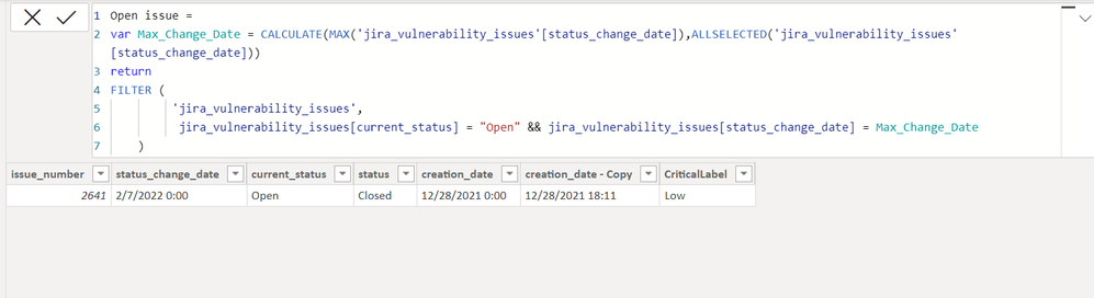

I need get table with only open tickets. The main column with status is current_status. I tried this dax code:
Open issue =
FILTER (
         'jira_vulnerability_issues',
          jira_vulnerability_issues[current_status] = "Open" && jira_vulnerability_issues[status_change_date] = [Max Change Date]
Max Change Date = CALCULATE(MAX('jira_vulnerability_issues'[status_change_date]),ALLSELECTED('jira_vulnerability_issues'[status_change_date]))
but it doesn't work
Okay so what I understand is that you want all the open tickets on the max change date.
Is this the result you want?
You can use
Open issue =
var Max_Change_Date = CALCULATE(MAX('jira_vulnerability_issues'[status_change_date]),ALLSELECTED('jira_vulnerability_issues'[status_change_date]))
return
FILTER (
          jira_vulnerability_issues[current_status] = "Open" && jira_vulnerability_issues[status_change_date] = Max_Change_Date

Sorry, i forgot a part of dax measure. my measure is the same, but it doesn't work (i get all tickets with closed state too)

@vaalyushin Maybe:
Table =
  VAR __Table = SUMMARIZE('Table',[issue_number],"last_date",MAX('Table'[status_change_date]))
  VAR __Table1 =
    ADDCOLUMNS(
      __Table,
      "current_status",
          VAR __issue = [issue_number]
          VAR __date = [last_date]
          MAXX(FILTER('Table',[issue_number] = __issue && [status_change_date] = __date),[current_status)
  FILTER(__Table1,[current_status] = "Open")
