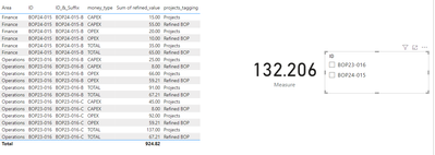

Hi Everyone. Asking for your help in creating DAX
I would like to get the value in another column based on unique id. The value that I want ot get has the same values in another rows due to multiple criteria.
In my example below. I want to get only the 67.206 in refined_value column with unique ID of BOP23-016 and money_type of "Total" under "Refined BOP". The reason that the TOTAL 67.206 is duplicated is because of the sub ids  (projects)  in ID_&_Suffix column which are under the unique ID BOP23-016. I don't want to add the 67.206 "TOTAL" of "Refined BOP" with sub IDs  BOP23-016-B and BOP23-016-C. I want to just appear the value once because they have unique ID (BOP23-016)
I tried to search for solutions in the community but got no luck.
Thank you in advance and I highly appreciate your help.
-Third

Hi @Anonymous
Thank you for your reply.
This is good. However, when I tried to put a slicer to check if the measure is dyamic, it doesn't change based on the ID I've selected. So for example, if I select ID BOP23-016, I am expecting that the value is 67.21,

@Anonymous  Thank you very much for your help. This works well.

Hi @Greg_Deckler
Thank you for your response. I notice that it onlty applies to one unique ID. However, if I have another Unique ID with the same data scenario, it does not add up the values under  "TOTAL" and "Refined BOP". So, I want to sum the 67.206 and 65 = 132.206
I tried to remove the first variable, but it has the same result.
-Third

Hi @Greg_Deckler
I tried your revised DAX, but I am still getting a wrong sum of values.
