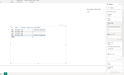

Place the filter measure like this:
tests:
Changing values of debt 500 -> 600 and 300 -> 250
This should return 3 rows for AAA and 1 for BBB:
The test works as expected.
The logic here is to use inverse running total to compute the breakpoint when the debt becomes negative instead of positive. This date marks when the debt is paid. The filter measure returns rows which either have positive value or which are at this breakpoint.
