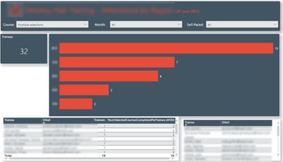

Hi @v-jianboli-msft,
In the other solutions/articles I read they had a common thing where they had (in my case) a measure to calculate courses completed per employee (like my second measure) and filtered visuals simply by when [2nd measure] is not blank.
My attempt at this was the following:
Original Measure:
Trainees = DISTINCTCOUNT('Training Records'[Email])
Count By Row Measure:
coursesCompletedPerTrainee =
// count the number of criteria (courses) selected
var selectedCourses = VALUES(Course[Course])
var numSelectedCourses = COUNTROWS(selectedCourses)
// count the number of courses per trainee
var coursesPerTrainee = COUNTX(
FILTER('Training Records', RELATED(Course[Course]) in selectedCourses),
var ANDCheck = IF(coursesPerTrainee >= numSelectedCourses, 1)
//return non-blank if courses are not being filtered
return IF(ISFILTERED(Course[Course]),
ANDCheck, "Non-Blank")
This is the exact same as part of my current solution and it worked the same to filter some visuals (like tables) when it was not blank.
The issue/missing piece I needed was the total number of employees who had completed all selected courses while this measure only gave me the number of selected courses per employee.
Here is an old version of the report:
Although blurred out, the bottom right table gave me the correct employee records (a total of 18 rows) by filtering the visual when coursesCompletedPerTrainee is not blank.
The issue I was having is that the card visual 'Trainees' and the bar chart could not be filtered by this measure. (The card is just the original Trainees measure) and the bar chart is the Trainees measure by a column in the employee head count table.
You can see in the matrix visual though, the total it generated (18) is the value I was after instead of 32. If there was a way to filter my original measure by the second one so that it only counts the distinct Email rows returned when coursesCompletedPerTrainee is not blank (basically what the matrix visual is doing) to produce a total value - it would also need to work with the bar graph however - only include the rows when the other measure is not blank.
I wasn't able to figure out a way to do this/if it was possible so I instead came up with my workaround solution to get the job done.
The fact that the total is able to be calculated by the matrix though made me wonder if the entire first measure was necessary when it seems to (kind of) be calculated via the second measure anyway.
Let me know what you think!
Charlotte 🙂
