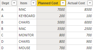

I've 2 tables as below. I want to filter the first table based on the data available in table 2.
DeptItemPlanned CostActual Cost
AMAC70008500
Amonitor200100
Akeyboard200100
Amouse200100
Bchairs50006000
BMAC35002500
BTV1000750
Bkeyboard150100
CCoffee7555
CChairs650450
Cmonitor800700
Cdesk1000650
Dchairs800900
DMAC100007500
DMouse700300
DEPTITEM
AMAC
AKEYBOARD
BCHAIRS
Bmac
Cmonitor
Dmouse
Dchairs
Expecting :
AMAC70008500
Akeyboard200100
Bchairs50006000
BMAC35002500
CCoffee7555
Cmonitor800700
Dchairs800900
DMAC100007500
DMouse700300

@disturbedspace - You might want to build a composite key column in both tables like this:
Key = [Dept] & ":" & [Item]
Then you can relate your tables. I would recommend changing all of your values to all lower or all uppercase in Power Query as well.

@disturbedspace
You can do a power query merge to get the result you need.
You can check the attached file.
Check your results table, there are some descripancies
