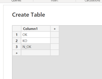

I included all the data in the same table in my example, since from a data modelling perspective it would be good if you added all the relevant details into a single table using powerquery. Other option is to use functions like RELATED to get the information to a single table.
For slicer options  you can create a slicer table and use that in combination with a measure. E.g.
SlicerMeasure_ = IF(ISFILTERED('Table (9)'),
IF([Test]=MAX('Table (9)'[Column1]),1,0),1
Thank you so much for your help. It worked!
