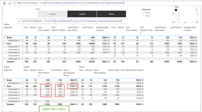

I've missed an important info in my first post - my bad. I need to weight the prices with the same volume. This is my updated data table:
and then the problem:
I tried with calculate sum and sumx and filter the 0 but still the subtotals and totals are wrong - I want to calculate the index (on product, segment and brand level) only for those products that both brands have.
I need a measure that compares dynamically for every brand in the table, when selected, the price weighted with volume to the price weighted with the same volume of my main brand e.g nivea but only for those product, that both brands have in the same time. Something like a true/false check measure, if (or(product (selected brand) = Blank(), product (nivea)=Black()9, false(), true())

But I think it's still not working properly. I need to compare every brand to Nivea, Nivea should be always 100%, I fixed this, I changed your All Brands measure to
"ALL Brands = CALCULATE([Avg Price], Products[Brand]="Nivea")"
But then for the segment "Body" is still calculates wrong - because inside this segment there is only one product - Bodylotion 3 that both of the brands (Loreal & Nivea) have. The index should be 300/150=2 and not 1,43 ( I don't understand where 1,43 is coming from)

Anyways I created the Loreal versionthe index vs Loreal looks correct.  Body Lotion 3 is 1 for Loreal, .5 for Nivea and .1 for the other brand, at $2 vs. $20, that looks correct.
