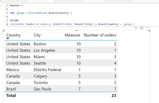

@SvenCleut - You need to show me the DAX you are using, whether you are using it in a Measure or in a column, sen some screenshots of your model, or file share your PBIX for me to resolve this.
If you had copied the DAX structure exactly as I had given to you, I dont think this would be an issue. For reference, below is a screenshot of my DAX, and you can see it does not show cities that do not belong to countries:

Hi @mark_endicott ,
You were right the code is correct. Only I had more columns in my table that caused it to filter on them. I had to put all these columns into the dax code using the REMOVEFILTERS() function. Thanks!
