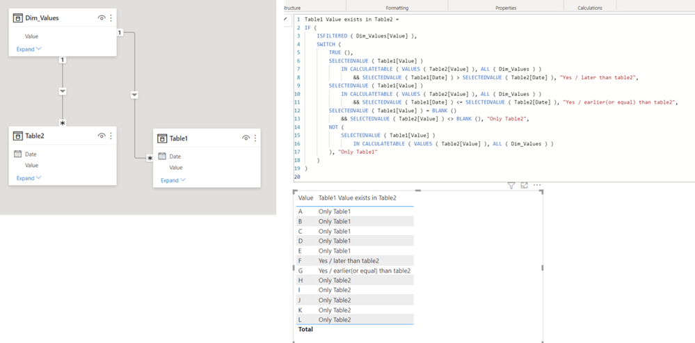

I tried to create a sample pbix file based on the explanation.
I am not sure whether I understood your question correctly, but please check the below picture and the sample pbix file.
Table1 Value exists in Table2 =
IF (
ISFILTERED ( Dim_Values[Value] ),
SWITCH (
TRUE (),
SELECTEDVALUE ( Table1[Value] )
IN CALCULATETABLE ( VALUES ( Table2[Value] ), ALL ( Dim_Values ) )
&& SELECTEDVALUE ( Table1[Date] ) > SELECTEDVALUE ( Table2[Date] ), "Yes / later than table2",
&& SELECTEDVALUE ( Table1[Date] ) <= SELECTEDVALUE ( Table2[Date] ), "Yes / earlier(or equal) than table2",
SELECTEDVALUE ( Table1[Value] ) = BLANK ()
&& SELECTEDVALUE ( Table2[Value] ) <> BLANK (), "Only Table2",
NOT (
), "Only Table1"
https://www.dropbox.com/s/r72e077i33gpve9/kesera.pbix?dl=0
