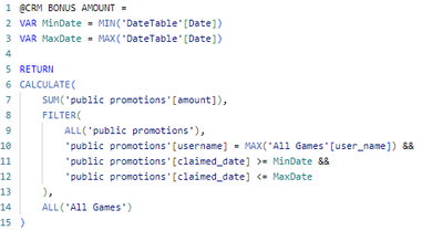

I have this column formula as my slicer for my segmentation but it is not working properly.
UAP means Bet > 0
w/ Deposit means Deposit > 0
w/ Bonus means Bonus > 0
The Segmentation Slicer
Table Relationship
Sample Table
Player  = public register customer_name (default column)
Bet = All Games FilteredBet (dax column)
Deposit = public register CRM DEPOSIT AMOUNT (dax measure)
Bonus = public register CRM BONUS AMOUNT (dax measure)
I don't know if the problem is in the relationship table or the formula's I used because when I'm selecting a slicer it does not give me the correct result.

To address the issue you're facing with your segmentation slicer not working properly, let's take a systematic approach:
1. Understand the Expected Behavior of Your Segmentation
Your slicer categorizes players into the following segments based on these conditions:
  • UAP: Bet > 0
  • w/ Deposit: Deposit > 0
  • w/ Bonus: Bonus > 0
The slicer should properly filter the data in your visualizations.
2. Potential Issues to Check
The issue might arise from:
  1. Relationships in the Model: Ensure proper relationships are established between your tables (e.g., "Player Table" and "Transactions Table").
  2. DAX Logic for Columns/Measures: Verify the formulas you're using for the slicer and segmentation.
  3. Data Granularity: Ensure the tables you're working with align on a common granularity, such as Player.
3. Verify Table Relationships
From the screenshots (or descriptions of your model), confirm these:
  • Primary Table: You are likely using a "Player" table that includes customer names or IDs as the key.
  • Transactions Table: This table contains Bet, Deposit, and Bonus information.
  • Relationships should be one-to-many or many-to-one as follows:
    • Player Table[PlayerID] → Transactions Table[PlayerID]
4. Correct DAX for Your Columns
Use calculated columns to segment players based on their Bet, Deposit, and Bonus values.
DAX for Segmentation (Calculated Column)
Create a new calculated column in the Player Table to segment players:
Segmentation =
SWITCH(
    TRUE(),
    [Bet] > 0, "UAP",
    [Deposit] > 0, "w/ Deposit",
    [Bonus] > 0, "w/ Bonus",
    "No Activity"
This column categorizes players based on their first matching condition.
5. Alternative: Use Measures for Granularity
If the Bet, Deposit, and Bonus are calculated using measures, you cannot directly use them in a calculated column. Instead, create a Segmentation Measure:
Segmentation Measure =
SWITCH(
    TRUE(),
    MAX('Transactions Table'[Bet]) > 0, "UAP",
    MAX('Transactions Table'[Deposit]) > 0, "w/ Deposit",
    MAX('Transactions Table'[Bonus]) > 0, "w/ Bonus",
    "No Activity"
Add this measure to your slicer visual. Power BI supports measures as slicer inputs since it dynamically computes based on the visual context.
6. Check Slicer Configuration
Ensure that your slicer is set up properly:
  1. Add the Segmentation column (or measure) to the slicer visual.
  2. Set the slicer to filter all visuals properly.
7. Verify Filter Behavior
  • Select one segmentation option in the slicer and observe if it filters the table/visual correctly.
  • If it doesn't work:
    • Recheck your relationships.
    • Ensure the Bet, Deposit, and Bonus values are correctly aggregated.
8. Debugging Tips
If the slicer still behaves incorrectly:
  1. Use a table visual to display Player, Bet, Deposit, and Bonus side-by-side with Segmentation. This helps verify that your DAX logic and relationships are correct.
  2. Check if the slicer is filtering the expected field (e.g., Player).
  • Ensure Consistent Granularity: If the "Transactions" table contains multiple rows per player, aggregate the data (e.g., SUM, MAX) at the player level before applying segmentation.
  • Avoid Duplicates: Ensure the relationships don't introduce duplicate data for players.
