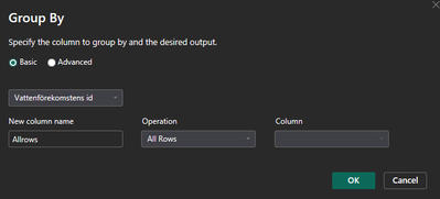

Hi, first group your data using ALLROWS
then add custom column
paramList = List.Transform([Allrows][Parameter], each _)
if List.Contains(paramList, "PTI") and List.Contains(paramList, "Totalbiomassa") then 1 else null
and then expand allrows column
