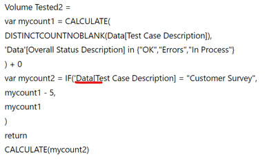

Volume Tested2 =
var mycount1 = CALCULATE(
DISTINCTCOUNTNOBLANK(Data[Test Case Description]),
'Data'[Overall Status Description] in {"OK","Errors","In Process"}
) + 0
var mycount2 = IF('Data[Test Case Description] = "Customer Survey",
mycount1 - 5,
mycount1
return
CALCULATE(mycount2)
Tried a bunch of variations on this but I am obviously  missing something fundamental.
These are the syntax errors I see which correspond to the line numbers you mentioned
Use 'Data' instead of 'Data
Regards
