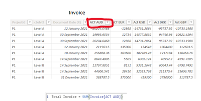

      Following are the two fact tables, with pre-existing currency values columns.
      I have created two simple measures to sum one column of the currency (AUD in this case) and a third one to calculate the difference:

      In addition to this, I would like to include the feasibility of including the currency selection (selecting the relevant column from both the fact tables)
      For example, if we select DKK from the slicer, the matrix below should show the sum of DKK columns from Budget and Invoice, and their respective difference for the selected Time Intelligence slicer (Calculation Group).
      One option is to unpivot the fact tables, with Currency as one column, but due to the sheer size of the table the solution is not feasible in long run. So, I was exploring if this can be achieved using calculation group.
