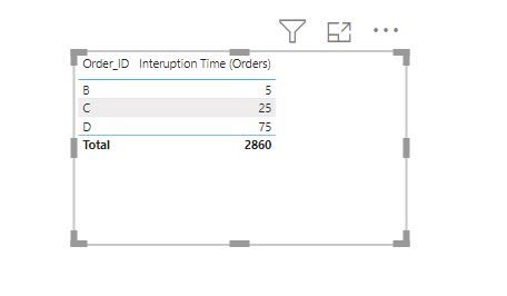

Hi Harsh,
Thanks for your solution! I have tested it, got the same results. It works almost perfect. The net dealy time for Case D is 75 minutes in stead of 85 minutes. The delay time is the 5 minutes from start I4 tot end I4 + the start from I5 untill the end of I7 (70 minutes). Makes a total of 75 minutes. The script adds somewhere 10 minutes to it. Do you have a solution for that?
Maybe I am overlooking something.
Thanks already for your support.

@RvdC ,
Hey thanks for pointing that out.
i had missed checking a gap in between interupption time.
Hope this works.
@RvdC ,
Thanks, There is a gap of 10 mins in between. I did not notice that.
Hope this works.

Thanks a lot for your help! All works fine for me.
Best,
Rob
