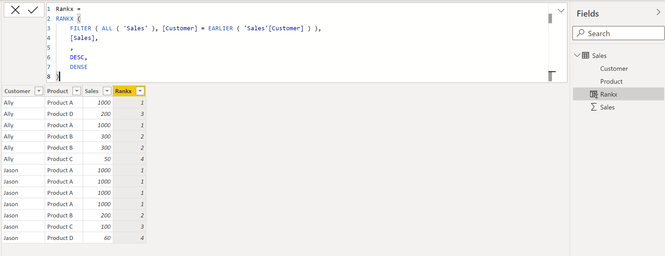

The problem is because of that change you did in the code, remove that SUM from line 4 in the code (based on the screenshot you sent)
try this and don't change anything (copy past):
Rankx =
RANKX (
FILTER ( ALL ( 'Sales' ), [Customer] = EARLIER ( 'Sales'[Customer] ) ),
[Sales],
DESC,
DENSE
Output:

Below is the screenshot of outcome in PowerBI:

Hi @Anonymous
Rankx =
RANKX (
[Sales],
DESC,
DENSE
Output:

Hi @VahidDM
It works!! You have helped to save my potential endless hours on trying to solve this!
I will go ahead and apply the same to my real case and hopefully it does not turn complicated!
Thank you so much!! Appreciate it!😀
