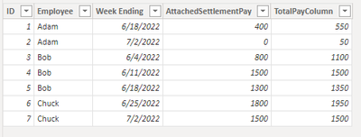

Here is the DAX of the calculate column:
TotalPayColumn = CALCULATE(SUM('CSV'[UnattachedSettlementPay]),FILTER('CSV',[Employee]=EARLIER('DATASET'[Employee])&&[Week Ending]=EARLIER('DATASET'[Week Ending]))) + [AttachedSettlementPay]Then You can put the column in Value field to achieve your purpose.
Final output:
If the result is not what you want, please give more details.
